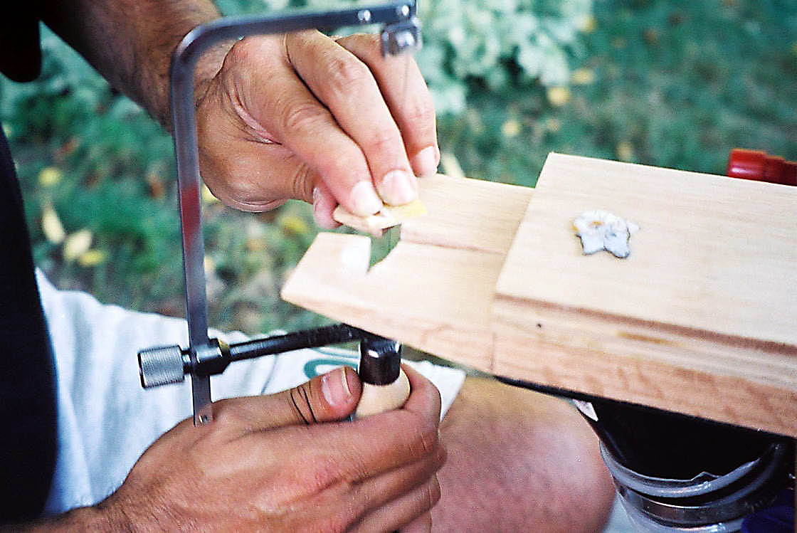

Turbo, you don't want to use a powered scroll saw (if this is what you have) for cutting pearl. It will grab the material on the upstroke and slam it down on the deck in the down stroke and that would be that.
You want to use a jewlers saw like the one pictured in Hesh's post. Cutting on the down stroke so the piece is supported by the cutting board.

Go with what Hesh shows above. I didn't buy the kit, but it is nearly identical to what I use. That outfit will work fine. You will need the dremel with several bits for the inlay pocket. I use 1/8 (hogging), 3/32, 1/16, and 1/32 bits.
